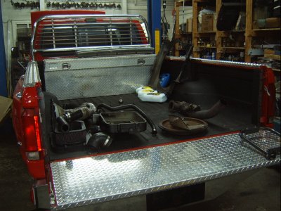

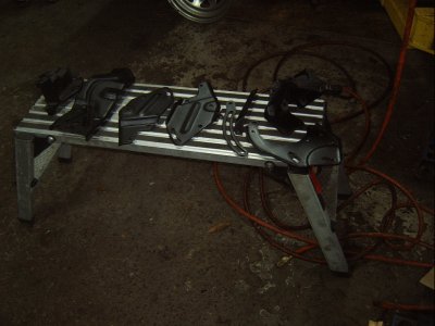

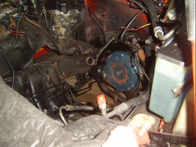

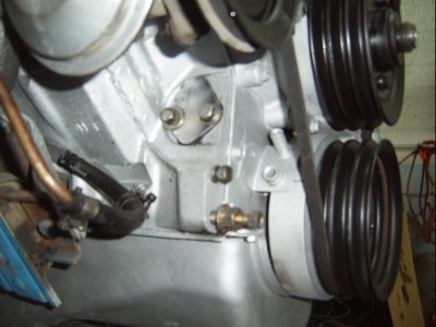

So the motor is out, the doner motor has received all of the necessary parts off the old motor. That took a lot longer than I thought it would take, well I guess everything did.
Here are some pics, notice the Chrome Chevy part. I found it on the old motor under a bunch of oil. We swapped the whole fuel system, glow plug system and all of the sensors. Cleaned and painted all of the brackets. Got a lot of finger prints on the new paint, should have painted the whole thing black,.cookoo
