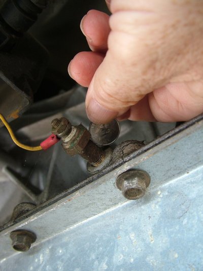

I have my trans temp sender in the E4OD test port. The sender feeds the Isspro gauge. There was no adapter necessary.

I had a B&M gauge sender installed directly in the test port on a 4r100 for about 6 years, was still functioning properly when I did the zf6 swap.
