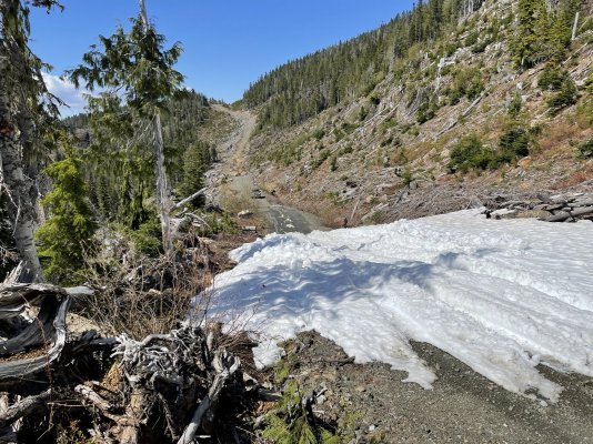

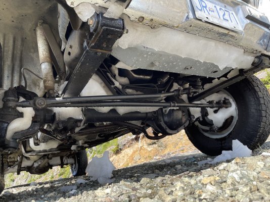

I think mine may have reached 190F at one point while climbing (ramming) uphill through snow melt (heavy stuff). The worst of it was early in the summer, before I installed the temp gauge so I don't know for sure how hot it was. But I figured it was safe to say some heat would be generated by a slow crawl that lasted 3 - 5 miles uphill, which is more common for the roads I visit. If I ever get my laptop working again, I want to try programming a lockup function when running in low range. Again, fuel economy is my main concern.
The attached photos tell the story of that particular run. Took about 2 dozen attempts to get through, but I wanted to reach the lookout.
