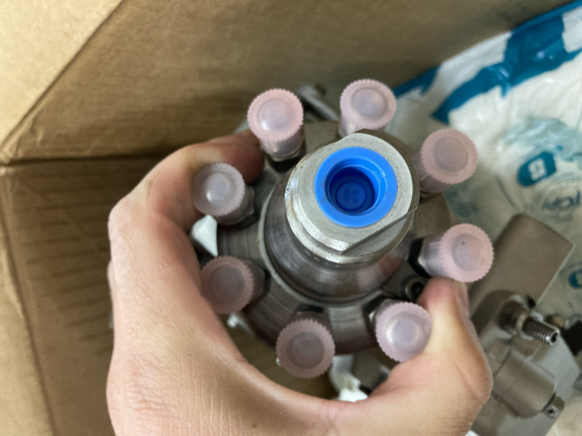

Got the injector bores cleaned out, new injectors in, fuel lines blown out with compressed air, and some other cleaning of parts. Still looks odd have fancy new shiny injectors on a dirty ol' engine. I should have spent my downtime waiting for the parts cleaning more but it was well spent with family, getting house chores done, and other important tasks. But anyway, I should probably install a new o-ring on this fitting that goes into the IP at the center of where all the hard lines come in. I'm thinking one of my extra viton rings for the top of the injectors (return line cap stuff) isn't going to cut it. Anyone have a part number by any chance or specs on one? I guess I could always take it into NAPA and match it up but hey, I've got a few minutes so why not post on the ol' forum!
Pic shows the viton ring from my surplus on there from. Obviously thicker than the original but fits snug.

I don't have the size but the type is for an o-ring boss(ORB). These are standard hydraulic type orings. I got a kit from amazon that has served me well(I do some minor work on our work trucks that have hydraulics, too) a NAPA or similar *may* have them...maybe not. Would be worth a call ahead. I can tell you that in hydraulic applications the "close enough" type of standard oring doesn't work, haha. But that's running 2-3k psi behind it. ;)

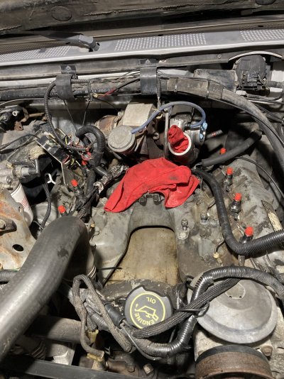

Truck drives pretty good with the camper but I have yet to pull the boat in line as well. He definitely sat all winter and I’m currently putting the injection pump in but damn, I swear there’s no way to place the lines and pump in with one shot. I know that’s what everyone says but damn they sure don’t make it easy! I have all the stuff moved out the way too!
Any tips out there for sliding this spider in as one unit??

You'll have to hold it with the rear injector lines at the lowest point and the work the pump into place. You may be able to remove a mounting stud from the IP housing to help it slide into place easier. I haven't tried that so I can't say if it will work or not.

Yeah I don’t know how others with a turbo got it all in one piece, Haynes manual and some other resources mentioned it. I ended up taking off the number 8 and 6 lines and it slid right in.
Those lines were pushing up against the firewall and there was no way around it to angle the pump gear downward into the cover. Good thing was I had access to those two lines for torquing down easily.
