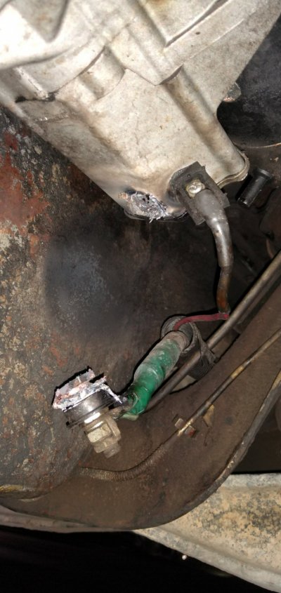

This is what my melted starter looked like when I first looked under the truck.

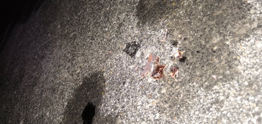

And this pic shows the puddles of previously molten copper that dripped from the starter to the asphalt.
