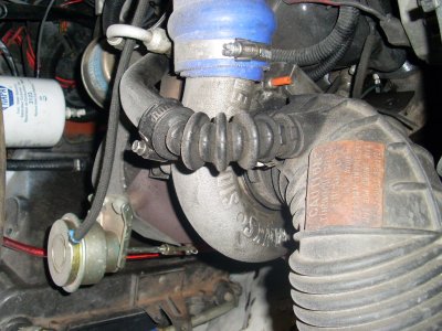

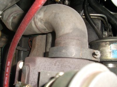

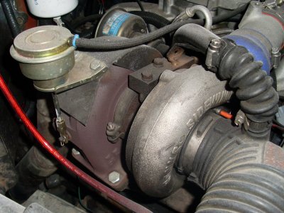

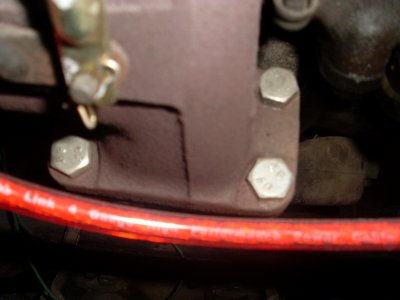

i have a GM 6.5 stock turbo manifolds with a Banks WG turbo(from a ford idi) mounted where the stocker should be. It will boost to 10psi before you would even know it.
That damn truck is wicked fast.:D;Sweet
