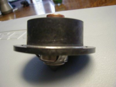

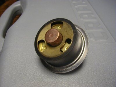

Agnem; said:
A lot of auto stores sell thermostats for these, but we've found that the only correct thermostat is the one from Ford or IH, and they are offered in only 1 temp. I believe there is one other that is documented, but I can never remember it.
Napa carries the correct one. Part # 385-190.
I've had one in the Beef now for 2 years without problems.;Sweet
The outer rubber ring is removed for Ford apps.
is it worth the hassle to change it over?
