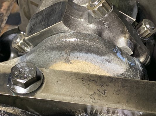

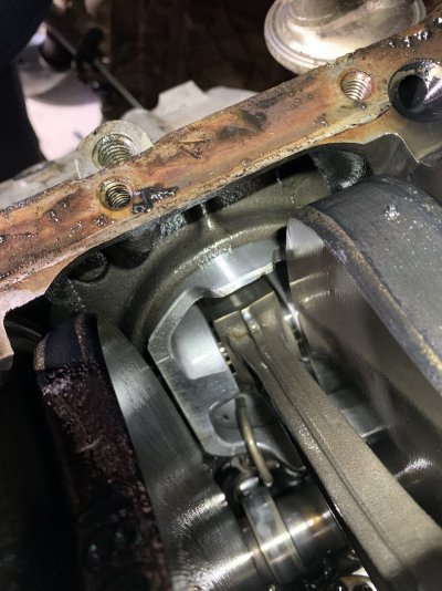

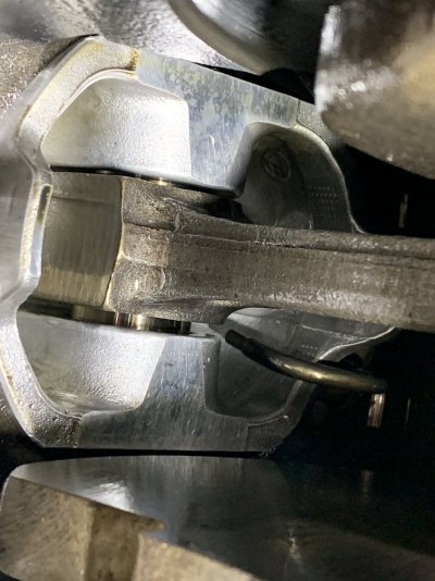

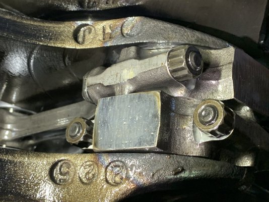

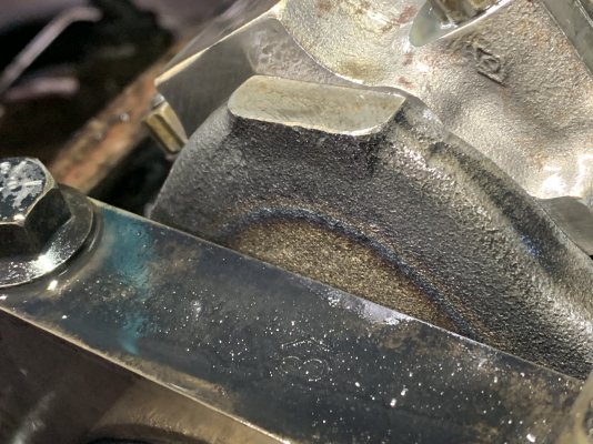

Crank rod journals show heat discoloration and the pistons…how can they be that clean? Truck has around 250k on it, I don’t really know it’s history.
Thoughts? Factory or rebuilt at some point? Should the pistons have ford markings or IH markings on them I can identify?

I'm no engine builder but why not just pull a cap and see what it looks like? Those pistons are pretty...maybe you got an engine where the PO actually changed the oil on the regular! :)

The heat marks you see on the crank are from the hardening process they do, it’s completely normal.

Ok, good to know. Thanks! Any idea what the crank weighs and what a bare block weighs? Wondering if I can get a bare block into my car without help.
