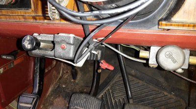

Never towed more than a single axle non braked trailer, but that's about to change! Truck came with the controller in the pic but its disconnected. Wires cut and taped. So my question is what kind of controller setup is this?

Look to see if it has a hard steel brakeline going to it. If it does, it's very old.

I bet if you look under the hood, the big resistor (a flat plate that looks like it has some springs attached to it) is out there too. That is old. If I remember right, the lever moves when you step on the brakes and to adjust it, you twist the knob. I would get rid of that thing if it were me. They are all solid state now.

Like this one.
338
That's a Kelsey-Hayse brake control. There a good controller, but hard to adjust the braking voltage. On a gravel surface at 30 MPH adjust the voltage just so the trailer wheels don't lockup and skid.
The adjusting knob slides the contact up and down on the wire wound resistor, closer to more or less voltage output.
There is no resistor under the hood. I am wondering if the Jamar unit next to the controller in my first pic was an after market replacement for this.
The lever on the controller does in fact move when I apply the brakes.
What would your reason be for getting rid of it? If I reconnect the wiring and it works what's the problem?

EDIT: to my post. I should have said to Apply the brakes MANUALLY when setting up at 30 MPH.
The only problem would be, if for some reason you would loose the truck brakes, you would have no trailer brakes unless applied manually. Example would be a rotted out brake line leak.

Just remembered, that Jamar unit could be for ABS system.

A modern unit, being solid state electronic, does not depend on a hydraulic brake line running into the cab. Having a hydraulic brake line inside the cab makes about as much sense as those mechanical oil pressure gauges, which have a pressurized oil line running inside the cab. One false move with a steel-toed boot, and it's not only a hot mess in the cab, but the breeched system is rendered inop.
