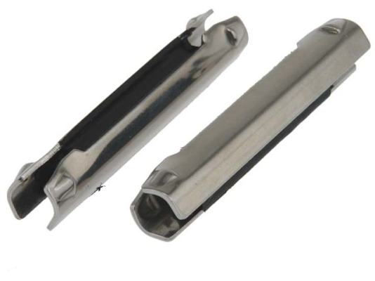

1 - some debris entered the system when you were replacing the calipers - causing the pistons to stick in the caliper.
2 - faulty calipers
3 - calipers binding on the stainless steel pins.
I would further troubleshoot by removing both front tires, and trying to turn the rotors by hand w/o the wheels for leverage. It this also reveals excessive drag on one side, see the list above.
IF however, the resistance felt between the two sides is the same, then I would have someone help by getting inside the truck and lightly applying brake pressure while you turn the front wheels/tires by hand - again with the goal of comparing from side to side. What you're trying to do is have them apply say 20% braking and then freeze their foot into place so that the force applied to the brake pedal is constant, while you compare ease of rotating the rim/tires on each side. If you notice a delta between the sides, have them apply 40% braking, etc.
What you may discover is that the side that it's not pulling towards is not applying brake force at the same rate as the other side - indicating air in the system on that side or something causing the calipers to retract more extensively than the opposite side.
Bottom line is that it either comes down to a caliper dragging or one that is not engaging as quickly as the opposite side.
