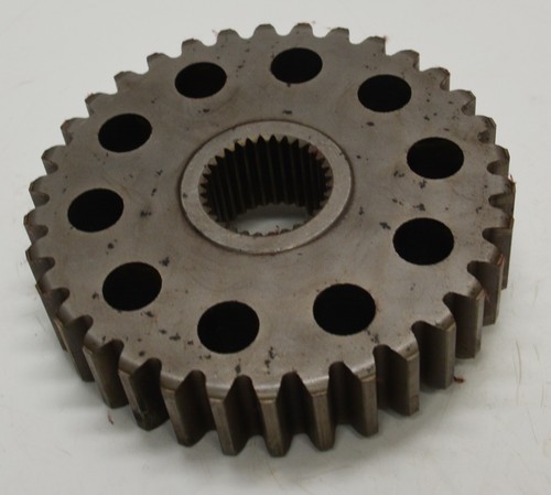

Only thing what i havent found is DRIVE SPROCKET, could anyone help me to find that sprocket on somewhere?
Would it be possible to get a part from a scrap yard, for example? If you can't get a new part from anywhere. Thanks!
I am asking this, because it’s hard to me find that part, we dont have those parts in here Finland.

I don't know about international shipping, but there are 2 on eBay. It also list it as being the same on a BW1370, and BW4401. Lists part number as # E7TZ-7177A
