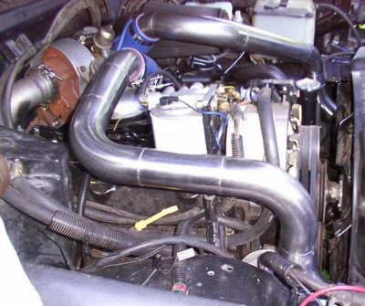

1. New FIPLS/MPLS/TPS, trans shifts better and pulls harder.
2. General Grabber red letters, so much smoother than my old BFG ATs look better and way more traction offroad.
3. modifide 3" stroke DP wraped up pipes and cross over and most of a 4" magnaflow exhaust with a turndown where the muffler gose until I get some pipe to put in there, Turbo whisles Like a **** and can make boost in nutral use way less throtle driving have more power and have to try real hard up a long steep grade to hit 1000 on the pyro, Thanks to mod 1 the trans will downshift if I don't do it just right and EGTs go way down.
4. Bigger transcooler never gets much over 150*

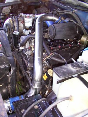

#1 on my list are my Dual stacks (sound and looks)
#2 Windstar electric fans (Hp and Mpgs)
#3 B&M shift kit (That poor E40D shur can stand some abuse now)
#4 Real gauges. Max I've seen: 236F coolant(stuck T-stat), 210F trans, and 1300F pyro.
#5 Coolant filter and Pre-mixed DCA additives coolant.
#6 Banks power pack lid (Hp, Mpgs, and quieter intake noise)
#7 Fresh fuel sysem. Injection pump supposedly set at 4200rpm but I've seen 4450rpm
