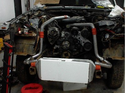

let me put the train of thought this way. just about every heavy pulling diesel has in IC hung on it. Truck manufacturers won't do anything without a really good reason to do so. without an IC, you can crank up the fuel but you have to watch the pyro and adjust your throttle accordingly, usually not in a good direction. My plug for the IC is that it is a passive power adder. you can install it and forget it unless you take a bullet in the IC. for most normal people that will never happen. You now gain a cooler/denser air charge and you can add more fuel as a result. You actually tend to use less fuel due to the fact you don't have your foot in the throttle as much. Yes, depending on the design, you may have some serviceability issues on the motor, but overall, the tradeoffs imho was well worth the expense. yes, my system cost me $1300, the engineering that went into it justifies the expense. I didn't have to cut into my radiator support!;Sweet
Pipes are too long.:D
Short pipes:
