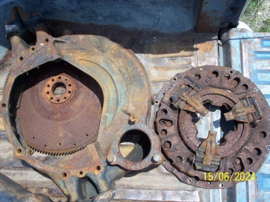

. Someone with a idi hooked to a school bus or u-haul SAE can confirm, but I believe those internationals have a adapter too. What I have been told, when you get to the bare idi block, it is a odd international bell pattern. If you want to go to a SAE pattern, you need a adapter for that also.
You mean something like this?
Hmmm....that has motor mounts cast into it doesn't it?

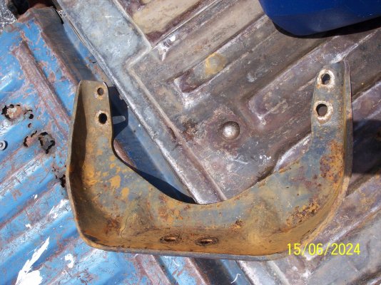

Yes. The rear two. The front one is separate. This bolts to the block where our batteries ground. If you ask me where IHCs have their batteries ground, I can't remember.
