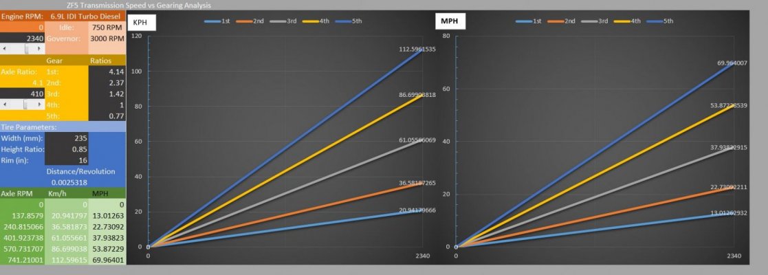

Not sure if this helps, but I put together a spreadsheet some time ago to evaluate different gear ratios and transmission combos. Here's a ZF5/4.10 combo. You can manually enter a different axle ratio if you want to see what the 4.56 ratio would look like. Hopefully the attachment work.

So many things to consider,
and I am not near as experienced as most others commenting in this thread. But I love Grimm Jeeper as well as @TNBrett mentioned. You would need 4.88 gear's to match what 3.55's and wide ratio guts would do in 1st and R.
Gear swap would limit your cruising speed and hurt mpg, you mention its your daily work pickup, in my situation, the CC would be used more than the RC's or SC's (I have 4 in my family).
Based on my comparisons, and reading others' experiences/suggestions: without making a budget comparison spreadsheet; I would keep the gears, and add a turbo, manual hubs, and wide ratio guts. This is most likely time consuming and expensive vs a gear/axle swap. What about finding super duty axles with factory 4.88's/5.13's? Would they bolt in..? Is there a kit available? I just think 4.10's/4.56's would not be enough...... They always say "don't fear the gear"
