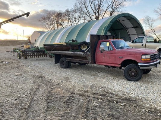

I have a F-Superduty 4x4 I’m about to sell…FYI
With its 5.13 gears, 235-85-16, and zf5 it’s spinning ~2850 rpm to go 65mph. Screaming by my standards, but doable. It’ll do interstate well enough at 65 but 60mph state highway is a joy. With 5.13 you can definitely use all 5 gears all the time.
Oh and it still has manual hubs so it’s got 2wd low range too as well as 4lo/4hi

What are the details of the truck? Any pictures?

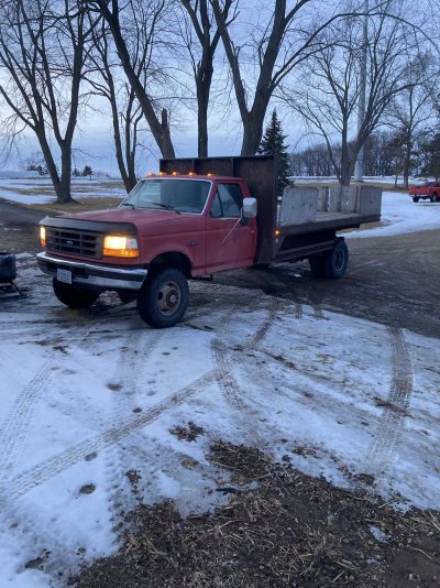

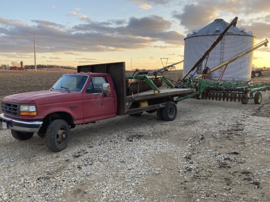

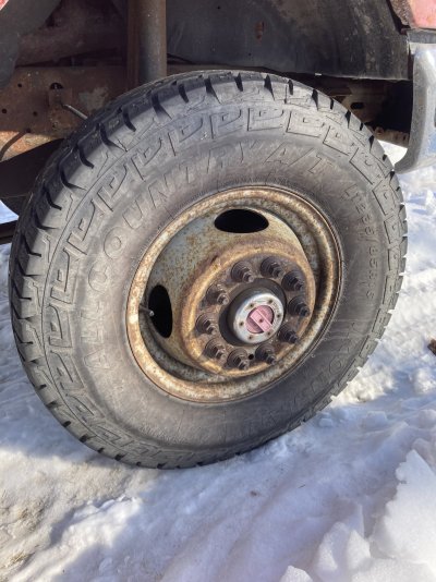

It’s a May 1994 truck with … a Powerstroke… ZF5, Quigley 4x4 conversion. 134k miles. Cab has rust but is serviceable for a few years yet or isn’t too far gone to fix the rust right now. Mounts are good, rockers are holey. 14’ flatbed.
I’ll post more details in marketplace when I put it up, don’t want to break discussion rules, but it is a great example of 5.13 capabilities!
