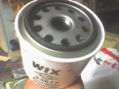

So a one piece filter does not use the filter bowl ?
That would be great. Last year I had to pay a tow truck to get home when my filter clogged. I had a spare and a wrench to get it off, just could not get the bowl off the old filter. I assume with this set-up the the warning lights don't work ?
386
If you get the one with the sensor connectors, then yes everything still works.
1,442
I posted the pics on another thread, but here they are again.

OK this is confusing. :confused: Are you saying there are 2 different 33617 filters? I cannot get my factory bowl to stop leaking, it would be nice to do away with it. But I definately need the water light to work. I can't really tell what that hole is in the pic, is that a water sensor?
I have my original bowl on the bench filled with brakleen and I see no leaks. So I'm pretty sure the o-ring surface is pitted enough that it just won't seal. -cuss
