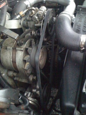

I should have tunred this picture before i posted it but as you can see its a small no resivoir steering pump with enternal modifcations delivering 50 to 65 psi, remeber forget the psi just did not get a chance to do a volume test. I now it looks like a factory install but its just me. the upper radiator hose had to be lengthened as it passed through the area that the pump was mounted in. so i bent and flared some aluminized exhaust pipe to fit the bill. works slicker than deer guts on a pump handle.

do you have som epart numbers and mre build info on the power steering pump? i agree the pump will only make enough pressure as the back pressure on it. i owuld still be leary about something getting plugged and blowing all my injector lines.
