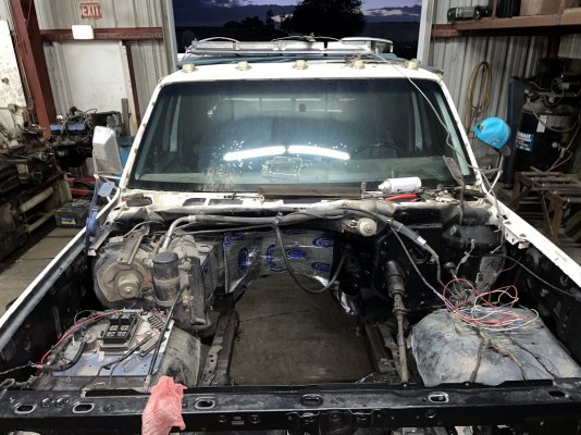

Finished the firewall. Had to add a little sheet off to one side because it was so thin on that corner. Rattle canned it all black (definitely hit it with a grinder first). Then I finally fully bolted the core support down and pretty much have the fenders mounted permanently. I’m waiting for some plastic shims to take place of my washers. With the fender liner in it actually is starting to look like a truck again. I don’t really have a whole lot of stuff left. I just don’t have a lot of time. Maybe I’ll just “have covid” for a week soon.

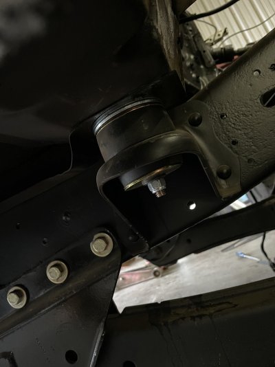

So I finally got the front clip mounted and the fender liners in. It took me a minute to get the fenders lined up and during the process it became very apparent that ford was not super focused on stuff being straight. The core support was 1/2 taller on one side. The driver fender that I got from my parts truck lines up with the top body line, but the lower body line is 1/2 inch off. This all made the front clip bind up and the door-fender clearance was all weird. To counteract that I just shimmed the front cab mounts. When I paint this I’m going to find a different fender and maybe can take the shims out. Not really something I’m super worried about though. I wouldn’t be super surprised if the cab is even a little tweaked from the accident judging by how messed up the frame was. All in all I think all of these old truck were built kinda weird.

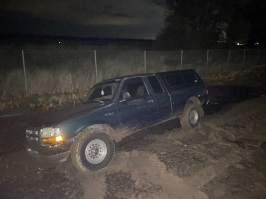

I figured you guys would like the pictures. I thought my bladder could last the 30 minute drive home from work, until I was about to *** myself. I lasted until my off ramp and tried to pull over on the shoulder real fast. There were a ton of leaves and I got sent off into the muddy ditch LOL. I had to call my GIRLFRIEND to come tow me out with her 4x4 ranger. She felt real cool.
