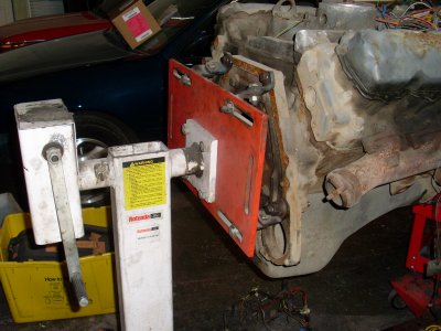

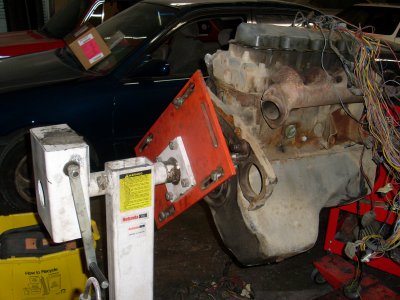

John... I have the same hf 2000 lbs stand but... I fabricated differnt mounting arms for it. I can use the top belhousing holes and... I can use the bottom mount points. I feel this utube guy has his motor improperly mounted to the stand. He is using the two lower bellhousing bolt locations. Thats putting plenty of pull on those mounts plus... He didn't balance the load so its easier to rotate the motor. Thats just plain dangerous to work around. If it fell no way could you get your feed or leggs out of the way. I really don't feel the guy knows much about these motors by the way he is talking about them.... But he sure can post something I can't.....
