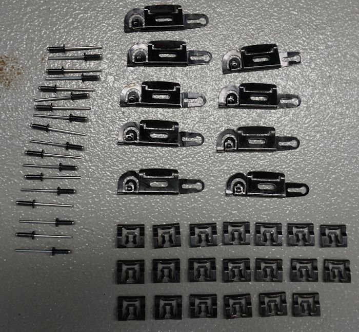

Did a search for the clips:
Thank you for the link, very useful.
One question I would have is that if the holes where existing pins are already rusted, new rivets in existing holes cannot be re-used, right ? New holes to be drilled to install new pins, isecn areas where metal is stil solid.
A friend of mine has 91 F250 and when we looked in that area one day it was found, that after removing debri dirt dead insects bird poo rust mixed with remants of uretane there was almost no solid metal left in that area, Just perforated metal foil....
When it gets that bad, you pretty much have to cut out old metal, and weld in new.
