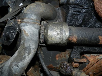

Ok there's the offending part, you can see where the dirt is rubbed off just behind he brake line that it hit.
and there's the header where it hits on the second pipe worst and is just touching on the first from the left

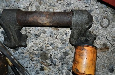

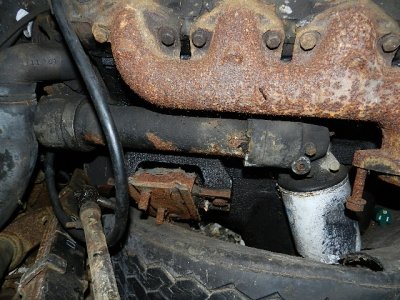

you have a truck cooler in there, i have a van motor and a truck cooler in my garage you can see in my pics. the first two pictures are the van motor, the filter slants to the back of the motor a little at the bottom but the big difference is that it does not rise the cooler up. the truck cooler raises up about 3-4 inches and the filter tilts the front of the motor at the bottom, you can see it in your pic and my last one.
