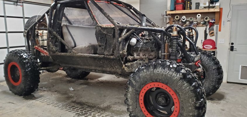

Update from a year ago,
Re-did both the front and rear suspension to shorten the links and get them up off the rocks.
Lowered it 2" and slimmed down the frame and brackets underneath, gained almost 4" of clearance.
Boat sided the cab, for a 13" gain on the corners.
swapped to two piece drive shafts to keep them high up.
Ball joint eliminaters
Braided lines for everything including coolant.
Have a wide ratio ZF-5 waiting to put in at some point here soon and should be switching to 43" tires at some point.
Had to rebuild the turbo, broke two axel shafts and had a hub bearing completely fail and wipe out the entire driver side.
Rolled it 3 more times pretty much without any serious damage. The 6.9 just keep going.

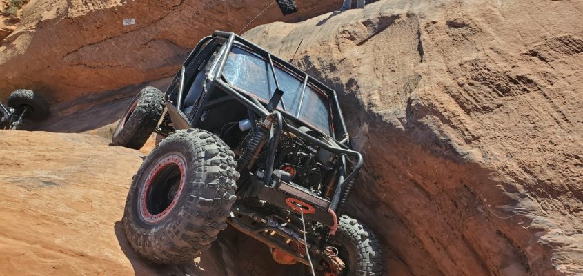

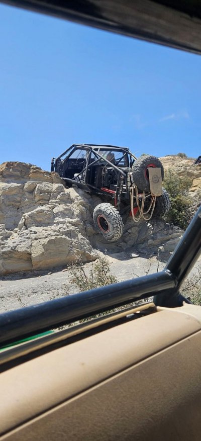

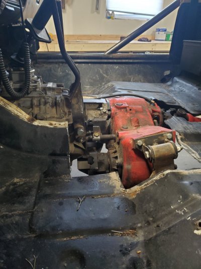

Well its taken years but I think it's finally found its final form.
It got a wide ratio ZF5 tucked way up into the frame a few years back along with some paint.
Went up to a 45" tire and lowered the suspension a bit.
Some other do dads like a vent catch can before it goes into the CDR and better lockers.
It's still kind of long but at this point I don't think I'll fix it, biggest downside is it's just too heavy.
I have been beating on this thing for close to 10 years now and it just won't quit.
