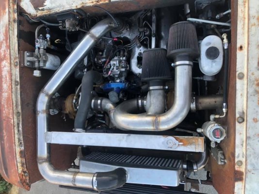

i ran 25 psi for years without failure on head bolts
