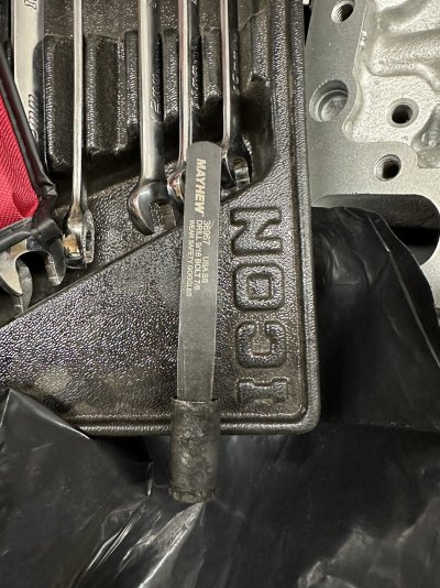

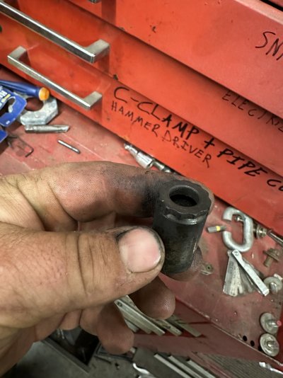

Got a few things done this weekend. Got the broken and stuck injector body out.
I absolutely hate that the machine shop didn’t do it when they were rebuilding the heads. I didn’t notice it and set the heads aside over a year ago and didn’t even look at them after picking them up. Anyways got it out, cleaned all the carbon out.

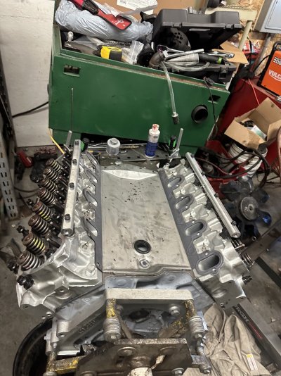

Got the r&d rails, stage 1 injectors and valley pan on.
Dropped off intake, ats air box and valve covers off to be blasted so I can cerakote them.

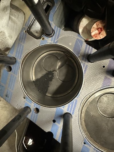

But as I say in the hotels after work I just couldn’t sleep with the fact I was putting used pistons back into my build. So with some effort and the swipe of a card, a brand new set of Mahle pistons came in and went in.
Plus I forgot that I had already bought the type4 cam when I bought Justin’s cam. So I have a brand new type4 cam for sale (willing to ship) and a set of used standard 4.110 turbo pistons.
Got it set in place and final torque.
