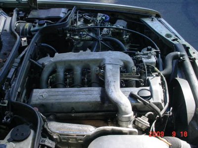

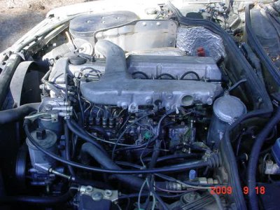

I picked up a 1986 Mercedes 300 SDL Sedan (see pics). It has the straight 6 turbo diesel in it. I plan on using the diesel in my 1950 F2.

Nice new toy there. I hope it's already been through the head replacement bit. Did you find out about that? That engine had a problem with the original head. They all end up getting replaced sooner or later.

The car came with a large 3 ring binder of receipts from the day it was bought up to a few months ago.
Yes the head was replaced on 11/8/2004 at the tune of $1295 for the head alone. The total bill paid was $2416.34. That is one spendy head.
This car has a bunch of new parts on it.
The deal was that the transmission was/is bad in the car. Only goes in reverse and 1st. I went through the receipts and the transmission only has 50,000 miles on it since being rebuilt. I called a few Mercedes shops and ask them their advice. They all told me that there is a micro switch under the gas pedal that controls the down shifting. When these switches go out or get stuck, the car thinks that it is at full throttle and keeps the transmission in first gear.
Needless to say, I must have "un-stuck" the switch with a few hard pushes of the gas pedal. I drove it around the neighborhood and it went through all the gears for me. My buddy drove it and had no problem either.

I wasn't even aware of an L6 diesel. Knew about the legendary L5, but that looks like a nice cruiser there. There aren't many cars that I would consider owning if I had use for, but the diesel mercedes is one of them.
The price for the head is not out of line. All the european and japanese diesels with aluminum heads cost around a grand WHEN, not if, they fail. The good news is that they usually go like hell and are very fun to drive when the maintenance is kept up.
