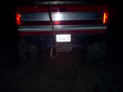

I just did mine today bed will come tommorow but I just put in a dually axle I got for really cheap. I would definitly change axles if i were you. but I had to put in wheel spacers to run my 35"s as far as front hubs on 2wd:dunno
