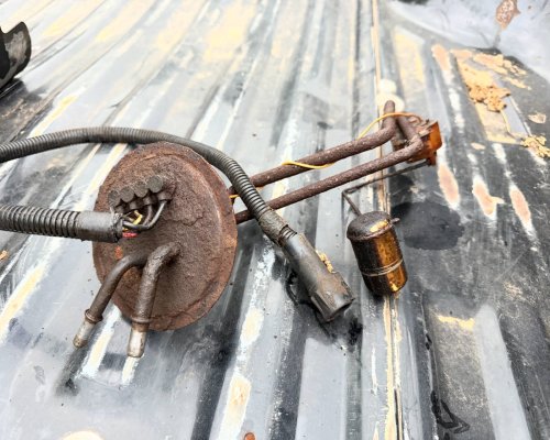

Ok. Got the front side tank pulled today, was not really as bad of a job as I thought. It still had about five gallons in it but I pulled the filler loose from the bed and luckily it had enough slack to reach the ground . Lines were a little hard to get disconnected, but some on blaster and working them around a bit got them broke loose for the tool. When I got the tank out and removed the severely rusted pickup tube assembly, I could not believe the amount said rust and debris in the tank. I now have a new pickup assembly on order before I can put the tank back on see.
If that speck represents the amount of rust in your tank........you're right.....that IS unbelievable......
