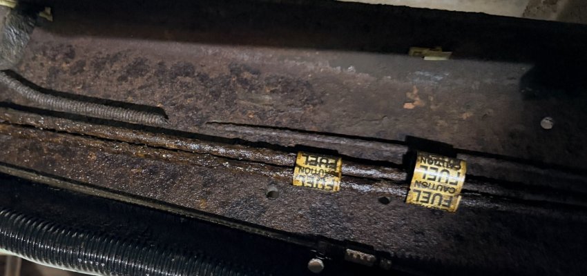

Not only is the tank rusted but I have worse leaks from the rear tank fuel lines running along the frame. The steel lines are completely rusted and dripping diesel everywhere
I was thinking original factory lines were black plastic? If you're replacing fuel lines you might consider PTFE with braided stainless sheath. Ebay has some great prices.
