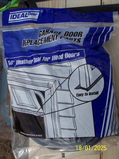

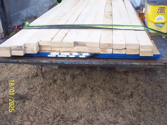

I've been wanting to build some shelves in my garage for a while now. A few days back, I realized that with L.A burning up, limber prices are going to skyrocket here soon. So before that and before Trump is sworn in and his tariffs take place, I decided that I'd better take my tail to Menards again. So I headed out to Kearney, NE at 6 AM. I did my normal three stops, spent too much money, stopped to drop off a couple of bill payments, and still got back to my garage by about 1:00. I felt pretty good about that. Then I stopped to visit a friend for a while and made tentative plans to go rabbit hunting tomorrow afternoon. I even picked up a little something for a couple of trucks while I was in Menards.
