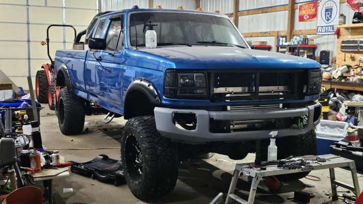

So I have all the guts back in the ol' boy and all the wiring. Been a long road, just about a year ago I started disassembling it and had the Dana 50 rebuilt, the transmission and xfer case rebuilt. The motor I had machined added new heads and I rebuilt it with all new internals minus crank and rods.
Tonight I stuck the batteries back in it and with the glow plugs out and fuel pump disconnected I used a remote trigger to turn the motor for the first time. It turned smoothly and no part introducing themselves to each other. That was a tremendous relief for me. I hit the starter about 4 times for about 15 seconds each. I did not show oil pressure to the turbo during that test but I am not sure if that would have been able to during those short bursts. It is also a new oil pump. Here are a couple picks of when I started and where I am so far

That is one nice-looking truck....period.
Thank you! I truly do appreciate you saying that. I tried to plan everything out well when I got started in earnest planning on rehabbing this ol' boy. I am pretty proud of how it is turning out. Hopefully it runs :)
