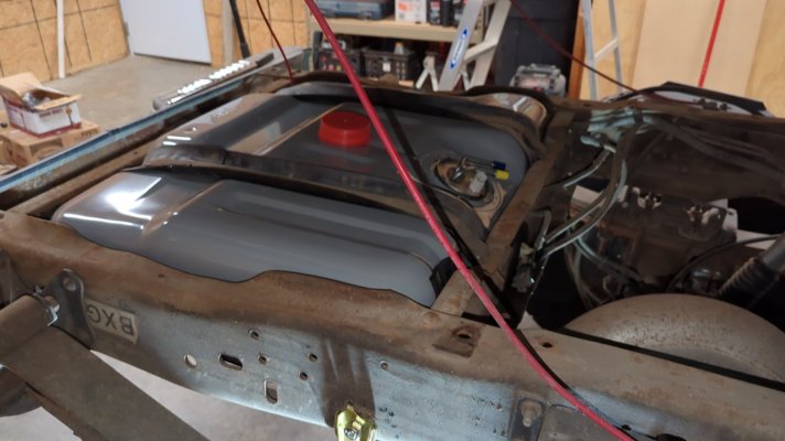

Went out to my truck Monday morning and wouldnt start. it would crank but no catch. my electric fuel pump had died. Even gave a few whacks for good measure but that didnt work either. so went inside and ordered a new one. then that night I got sick. so the pump came yesterday, but I was too sick to swap it out. Today I was feeling a little better so went out and swapped it out. I need to change some stuff on my filter and pump setup to make changing out the pump easier, but got it done. Now I am wiped put and ready to lay down.
I have some ideas on how to make my set up better so I am going to do some research on different pumps. I have a holley blue, but I am thinking of switching to one with more flow, which would mean a seperate return from the pressure regulator. I need to see what the 110cc pump from CCD needs for volume, I think @hacked89 has some posts on this stuff.
