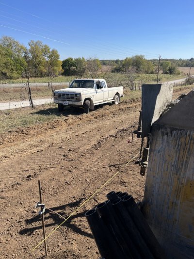

Made it back to Wilsey, no issues.
We were working about 2 hours east of Belleville, near Hiawatha. Not exactly feedlot country…

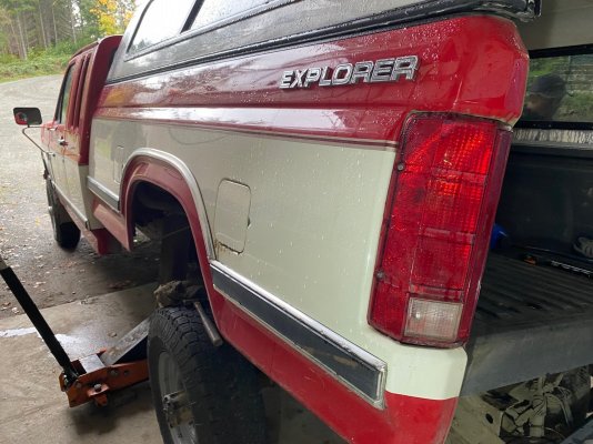

I discovered a cheat code on my truck. Apparently, you can access both fuel tank sending units without having to remove the tank, hack the bed floor, or even lift the bed.
Tilting it to the passenger side worked like a charm (leave the passenger side bolts in loose to act like a hinge).
I'm sure many of you already knew this trick, but I didn't. Only realized after seeing chevy guys doing this trick on YouTube (be nice, chevy owners are people, too).

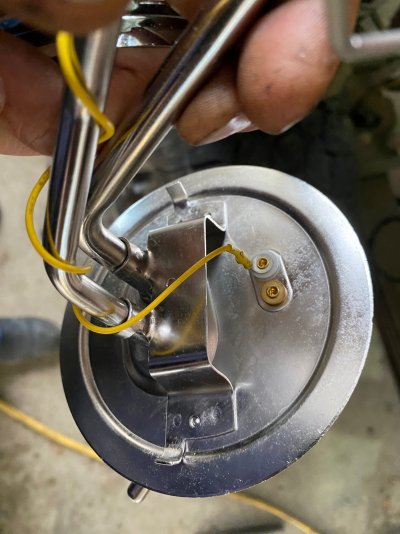

Also adding some photos of the new fuel sending unit. Looks like a very close match to the original but time will tell how it holds up.

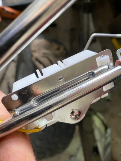

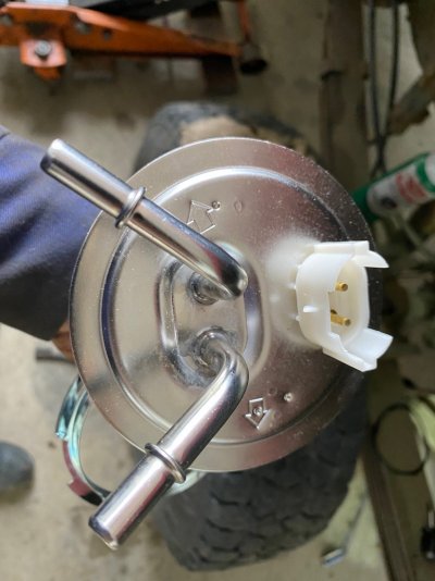

Another few photos of the new sending unit, if anyone's curious. Apparently the "shower heads" are now available separately, but the source I found was too expensive to ship, so I just replaced the whole thing.
