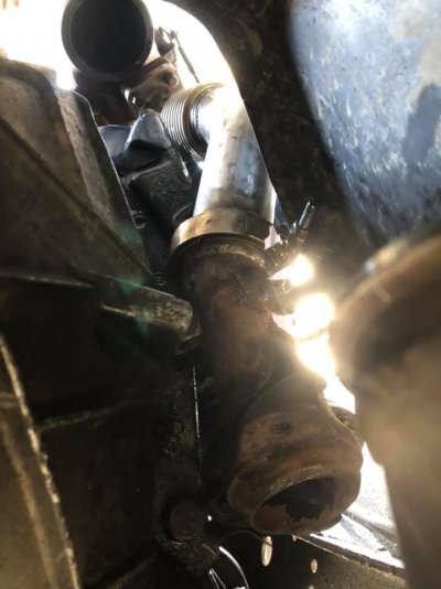

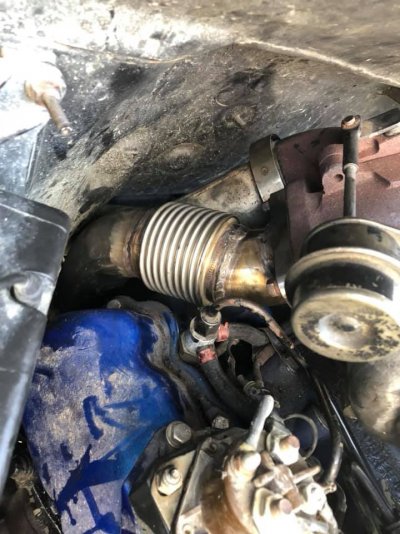

I just put @IDIoit up pipe on my truck and had to grind down the same spot. I talked to him and on his mock up piece it clears, on others it clears, on some it takes some grinding to clear. apparently all the intakes are a little bit different.
2,377
2,432

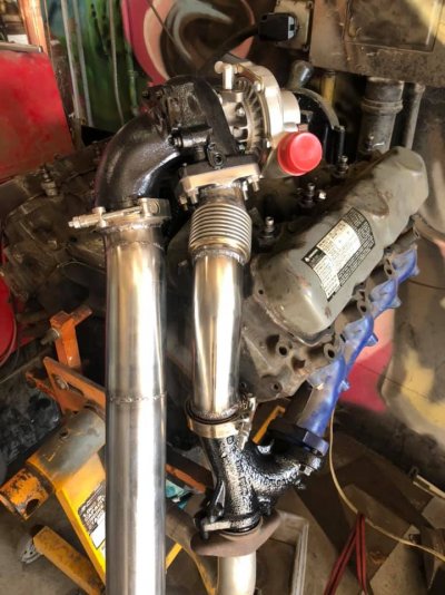

How close was the clearance on yours compared to mine?
13,324
3,897
i have also noticed that the casting nubs on the intakes differ greatly.
my mock up block, where all these up pipes are made still has the nub.
but everyones a little bit different.
also not limited to deck work on the block and head.
ive sold over 50 of these up pipes, and youre the first one thats had to use a shim.
theres no issue with using a shim, but that tells me that your turbo is bolted into a slightly different location than my mock up,
which is a factory turbo.
another thing worthy of mentioning is that if you have studs in the passenger exhaust manifold, i have found that it will not seal with the Y.
it causes a 1/8" gap between the manifold and the Y.
this will throw everything off too.
yes its a tight fit, i make them this way to ensure everyone clears the firewall without issues.
im here for you guys that have purchased these.
dont ever be apprehensive about contacting me about issues, no matter how small.

mine has a little more room than yours. I had much more trouble getting CDDs down pipe to clear the up pipe. It was rubbing on the v band clamp. Had to clock the clamp differently and put a small relief in the down pipe, but everything fits now and is sealed up great. The only issue is now the down pipe is rubbing on the body right where it comes out of the turbo, thus my thread on body mounts.
fired it up with just the down pipe to move it around. That was music to my ears!!:rock::rock:
2,377
2,432
I used the handle of a floor jack to convince my body to bend and have more clearance. I also had pancaked out my down pipe a little to fit, it's a tight fit with the zf in there.
@IDIoit what studs are you referring to? I have studs in my manifold, but it seemed to seal up. Haven't fired it up yet since putting it all together.
