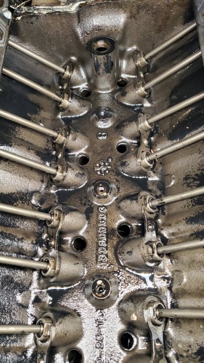

Made good progress towards getting lifters changed, but got distracted with my minivan, it needs so much

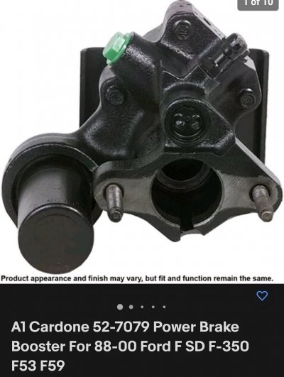

Also is this the right unit to convert to hydroboost?
