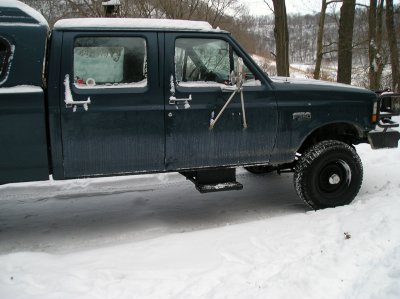

Finally installd a step on the passengers side so my Wife doesn't have to use a step stool to get in. She is happy now (at least for a little while)

Nice step! I bought a 77 250 that had something like that welded on the cab and frame, but not nearly as robust.
Love your truck!
