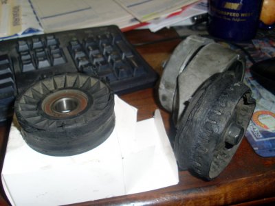

1,442
I have an extra tensioner assy and idler just for a precaution.
better to have than wishing I had one.;Sweet
attached pic is both tensioner and idler pulley aftermath when the vac pump locked up. could not pull over where it happened. this was what was found 5 mins later.:eek:
