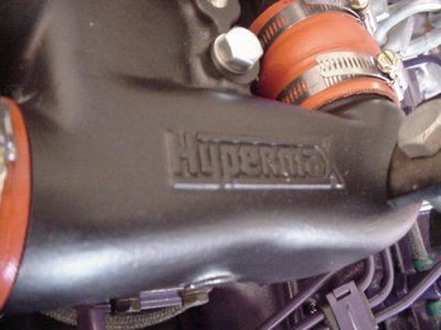

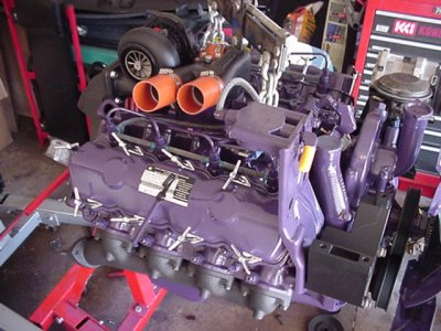

i thought they said AFTER 3000 miles re-torque them. but who knows :D
