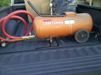

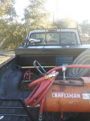

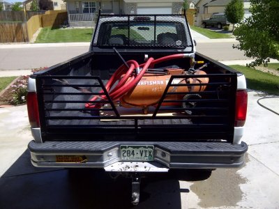

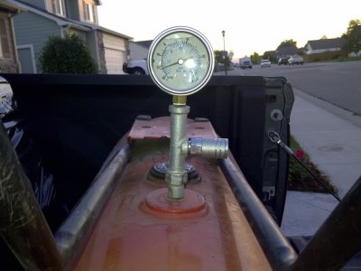

you can find blown Air compressors (w/ the tank) on Craiglist quite often for cheap to sometimes nothing. The tank you see in these pics I got for free w/o the compressor motor.
Here are a few pics of my super sucker. It's actually sitting in the bed of my pickup now full of soon to be fuel for my 94 :sly

Get a good pressure gauge, one that swings from 30 inches of vac, to 30 psi.
As for the vacuum pump, mine came from harbor freight and still ticking along just fine.

Found it in a local surplus store, used. It's an oil filled gage so I'm sure new it was expensive. I haven't shopped for new ones so can't offer help about who sells them cheap
I did see a vac/pressure gage at Harbor Freight in the automotive section for around $20. The limits on that gage as I recall are 20 psi, which is enough.
