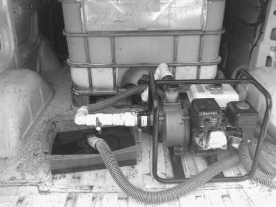

My setup for Wmo. Hope this help guys
Collection costs
275 gallon tank $75
Pool hose $39
Fittings $25
Waste pump - $149 harbor freight.........i got my honda for 35bucks on craigslist
Brass foot valve $15
Filtering and fueling costs
Pump-53 harborfreight
Filters-40 homedepot
10 micron final stage filter-30
Hose and nozzle-40
Meter-50 used
I can fill up in less than 10min. The drive to get my oil takes longer.
Hope this helps.
black12vbeast
Dec 31, 2011
Florida
Pics of Setup
Here are the pics
IMO the whole reason why we burn oil is to save money. Take it from me i started this in august and through trial an error, don't waste your time with small pumps and 12v setups they will burn out and take way too long. I have a 100 gallon in the back of the truck with 90/10 mix and it runs great, smokes because i am running heavy fueling 191, and bigger injectors. Installing water **** this week to minimize smoking. Keep you guys posted.
Ill try to take better photos, very sunny outside and took photo with my tablet.

black12vbeast
Dec 31, 2011
Florida
Trust me i wanted to burn my pump in the beginning with priming issues. But the key was installing thefoot valve and ball valve so i never lose prime. Just make sure you close them before you remove from source and when stored.
