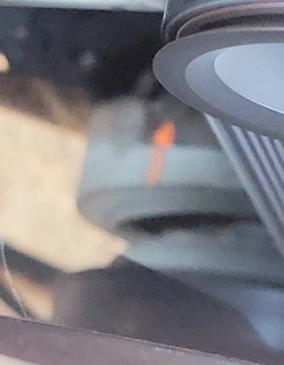

I tried using the mag pickup as a last resort, it still was a no go. After several attempts at adjustment with the light, I finally got it set to 8.5 ish. It wiggles a little, but it's practically at the line.
And you were right. Install timing was negative 3.5.
Good thing I have bright orange paint pen.
Also, I have yet to check compression on this engine. Original reason for excessive cold smoke was 3 dud glow plugs and I swapped unknown injectors in.
