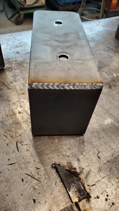

One brand of O ring seems to seal the bottom one better so it’s working again. I also got spontaneously evicted from my house/shop and started a new welding job. So I got all my tools back into my tool trailer and I am aggressively selling off a lot of my Datsun trucks/parts.
This new job is my first professional welding job (I used to be in computers) but here’s a photo of my first welds at work. I am just getting goin professional so I have a ways to go in weld quality just thought I’d share.

Sorry about your luck my dude, but at least your welds look clean as hell. You'll do well.

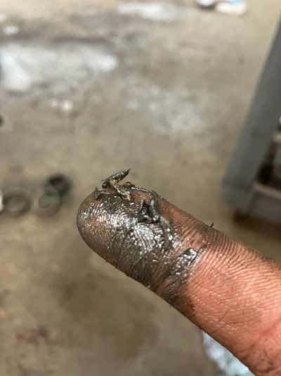

I replaced my steering Y link, my tie rods, tie rod ends, front brake hoses, adjusted my read brakes and sanded the shoes, took 6 degrees camber out of one front wheel on the alignment rack and replaced my front wheel bearings and races they we CHUNKY just shards left in there. Apparently I have a Dana 44 and I am also still batteling some return side fuel leaks leaks. Sometimes the factory gauge says 0PSI oil at idle but it does not make weird noises so some kind of gauge could be in the future and also my glow plug wire harnes is bad. Sorry about the lack of photos I don’t have my own shop anymore so I am always in a hurry borrowing shop space off others.

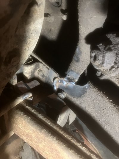

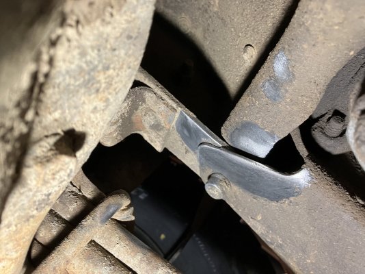

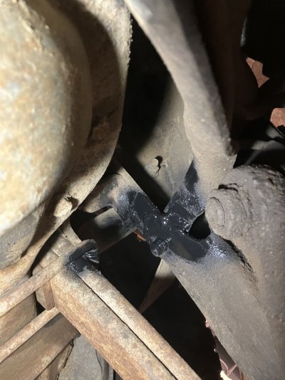

I had an issue where someone drilled out a rivet on the frame cross member next to the steering box and halfway stuck a bolt in but did not tighten it down so the steering box was moving the entire frame rail section when I tried to steer. So on lunch break today I welded all of that together no more frame flex! Steering is a lot better on the freeway and what not. Also the cruise control works! I am wondering if the plastic on my return line cap may be scored or something maybes it’s not an o ring issue.
Also please note this is not a “should you weld to your frame or not” discussion thread there is lots of threads other places devoted to discussing that, I welded my cross member to my frame while I was on lunch break at the metal fabrication shop I professionally weld at all day long using 035 wire out of a Lincoln power mig which is more than sufficient for the job.

No matter what someone's opinion may be on welding a frame. I think this is much safer than doing nothing would have been.

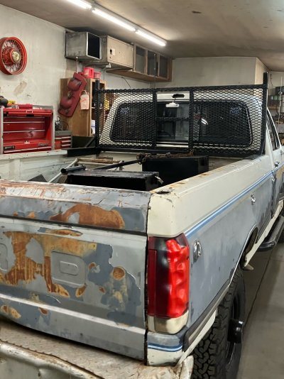

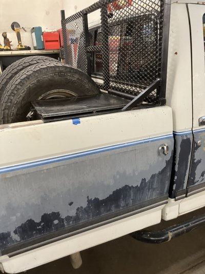

I had a headache rack I made for my last truck out of scrap metal and I adapted it for my 6.9 as the bed on the 6.9 is 2.25 inches wider. Now I just have to modify my custom toolbox setup for the new truck.

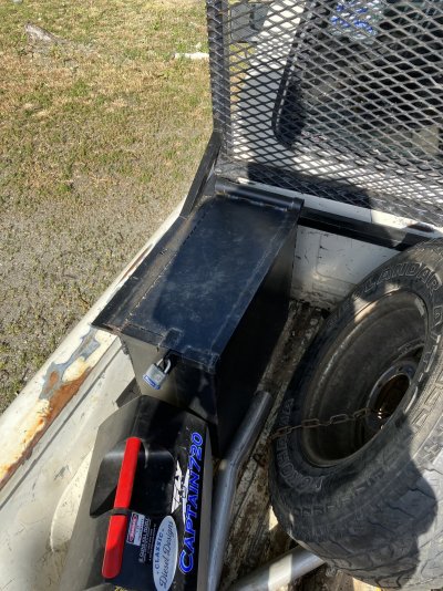

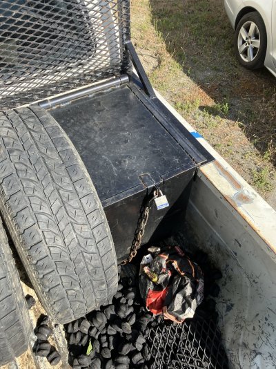

Custom fabricated toolboxes modified and installed today, getting the easy stuff done first. If I had a fuel gauge or I could start my truck from inside the truck that would be pretty cool but all in good time.
