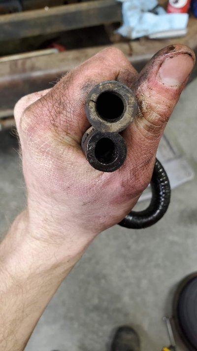

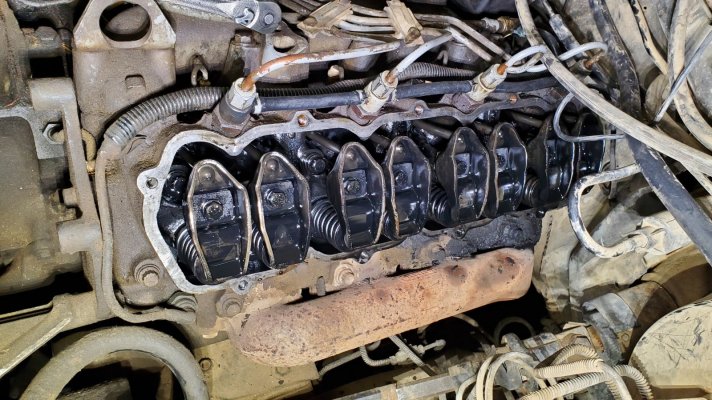

Got some work done on the truck, new brake booster line, some new fuel lines. Valve cover gaskets are getting replaced, old ones leaked really bad and I do not want to rebuild my starter and dump oil right onto it. Gasket was so bad it shattered when I touched it. It was much much cleaner under the valve covers than I expected, no sludge at all and only a couple of very very tiny rust spots. Pretty good for a truck that sat axles deep in mud for 8 years.

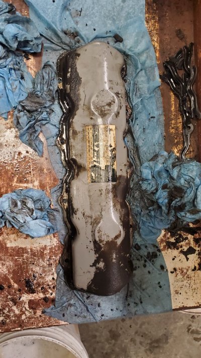

I even found a sticker under all the grease and dirt. It seems the factory painters did not do a good job at all? Both valve covers have many many drips on the paint but judging by the stickers and what not it seems to be factory.

It looks pretty normal under your valve covers. Surprisingly, these engines don't seem to build up much sludge as long as you keep up on the oil changes. The biggest cause of "sludge" that I've seen in when the valve guides go out on a 7.3.
