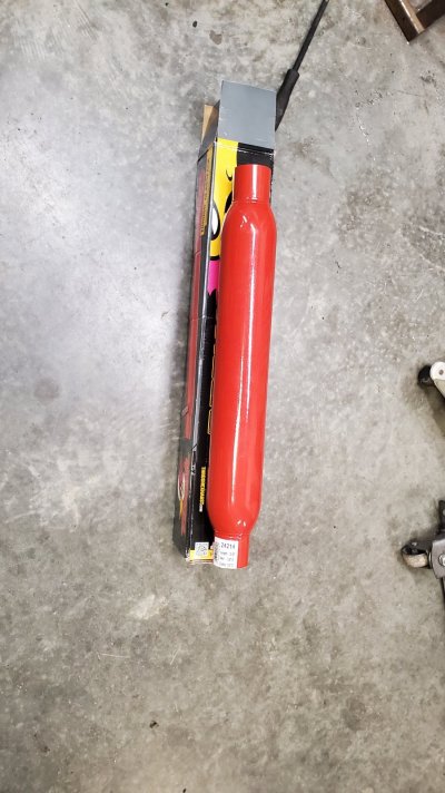

At some point someone put a big truck muffler in and ran 2.25 inch pipe out of it. It had 2.5 running into the muffler. I cut it off while working on something so now I am working on rigging up something slightly better, I would like larger but 2.5 is in the budget today. I am waiting on the glasspack to arrive in the mail. Also my new radiator fan got delayed in shipping.
