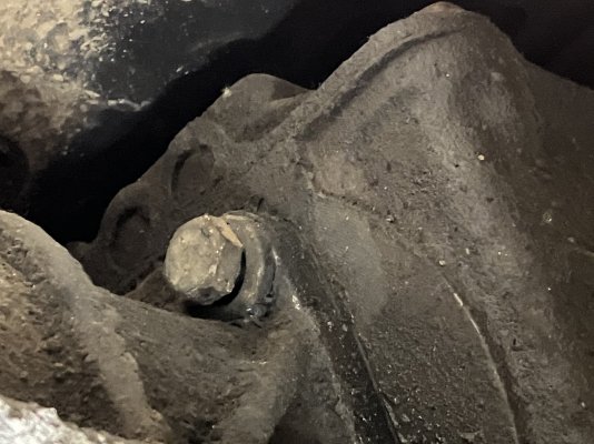

I went to check the gear oil level in my transmission yesterday night (it leaks) and all the bolts holding the transfer case in were falling out and only finger tight so I had to fix that before driving home from where I was.

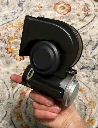

I bought this cheap air horn on Amazon so I will let you know how it sounds, priority is below the steering box but I can’t hear the factory horn over the diesel rattle so I wanted an upgrade.

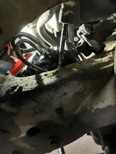

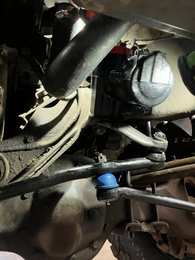

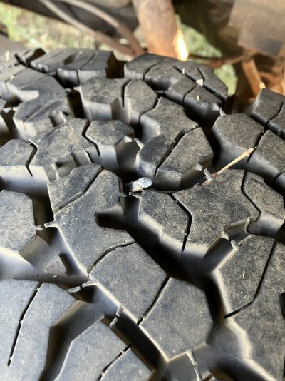

Well I got my new steering box in, I think I am one rag joint away from Javi mg the tightest steering brick nose in existence. The box was about $300 I think. One of my tires got impelled and my ignition switch is still having issues so I can’t drive it much yet, so far I’ve put 1500 miles on it in 8 months.
