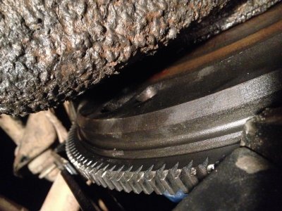

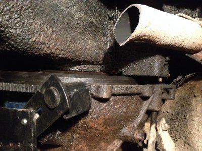

Well unbolting get the Torque Converter was a wast of time don't have a socket that short to get in there so I'm going to try and slide the Transmission off and leave the Torque Converter on the engine. Only other option is to remove the Raditator support and pull both together but then I have to fight 30 year old rusted bolts for the body mounts. :mad:

It was hung up on the dowel pins
Now it moves up down side to side so I'll try to wiggle it out tomorrow.
Or do y'all think it'll break free once I start pulling the engine?
I apologize for the stupid questions but it's my first time pulling a automatic.

no don't pull the engine out until you wiggle the trans loose.you wouldn't believe how hung up mine was in chip truck when i first pulled it (upgrade converter/pump mod) i had to wiggle and pry that mother for i think over an hour!
im sure you did but in case not,be sure to spray the dowels with penetrating oil so it can be soaking overnight for ya.

always unbolt the torque converter first.
the only reason you should leave it bolted up to the flex plate is when the engine is locked up.
and it WILL make a huge mess.
a box end wrench, with another doubled up on it for leverage works great.

These are the Torque Converter bolts not very easy to get too
Might as well take the core support and pull engine and transmission together.
