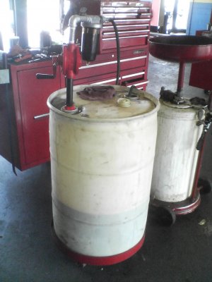

Here's my setup, just a 55 gal drum, a hand pump, and a filter setup from tractor supply with a water block. Total cost-about $45, Telling your friends you drive for free-priceless....
