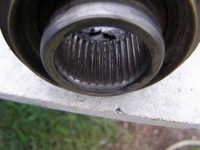

Well the vibration still persists. :mad:
I replaced the u-joint just behind the transfer case as it did show slop from inspecting it.
The vibration seems to be at the 2200-2600 rpm range in O/D. :confused:
It can be felt in the shifter for the t-case more that the trans shifter.
I pulled the pinion nut back off and inspected the yoke splines and from the pic, it can be seen that there is definite wear on the yoke splines.
I'm not sure if this could be the cause or not but am to the frustrated stage as I'm hitting the road this afternoon and will be taking the truck.
This is gonna be one good bug to figger out. -cuss
