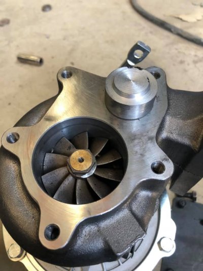

In the end its a fail, this kit has same bearing as the last. It is .01 smaller than the one that was pulled out. This hx35 is 3538868 and the number on the Bearing housing is 3530521, Im running out of options and dose not make sense.
They need a matching compressor housing, so got a nos one like came on the hx35.
The issue is with the he300, its cut for a hair bigger inducer and a bit bigger exducer. The hx35 housings are almost a perfect match for the wheels I have, there is a slight drag at the inside point of the exducer. May be hand sand them to fix that.

Called some holset distributors and found out oversize journal bearings exist, so a melett distributor to get one.
So the hx35 is now assembled and painted, just hope I did not over touqe the wheel. Yes the braker triped and there is no more light after running the heat gun.
