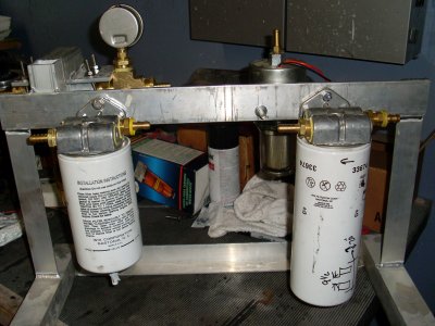

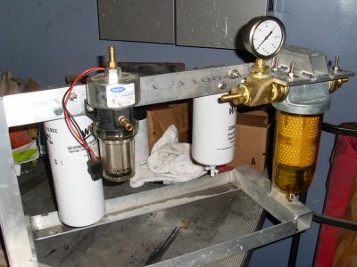

fuel is passing $3/gal these days, so the pain factor is being felt again. As a result, the filtration rig is back on the front burner. What I did gain in the two year of dormancy is a Carrier fuel pump and a goldenrod filter setup. here's the final assembled product before plumbing and electrical. it's actually going to be pretty easy to finish up. It's not as inexpensive as I originally anticipated, but I can service this setup almost anywhere which is the overriding goal. The latest Brass purchase came in at $75, the Carrier pump was $80(iirc) and the goldenrod filter was $40.
here are the pics....will be running testing this weekend;Sweet

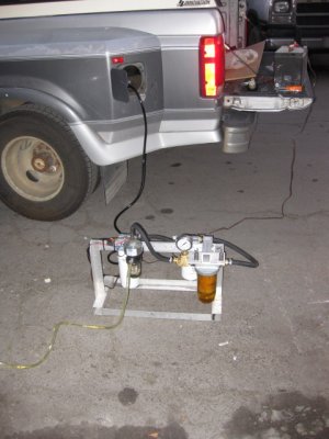

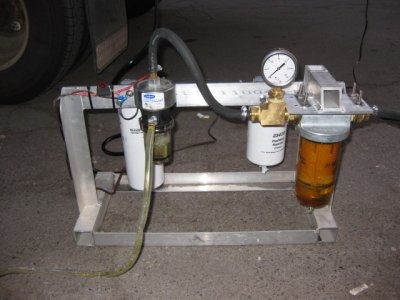

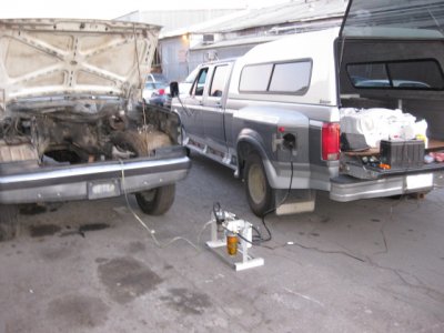

here's the final product in use;Sweet

I didn't want to have it in the bed of the truck for the operational test so I can check for leaks. The stuff in the donor truck was Bio-D of an unknown cut. Any spillage would reek for a long time. I have a 30gal tank out of a Isuzu box truck that will serve as my collection/mix/cut tank. I figure I'll throw it in the bed and dump in the fuel and WMO mix and have pump and filters recirc for a couple of days before I throw it into my truck tanks. I'll post a pic of the setup later.
one other thing....that carrier pump is one pumpin' SOB. drained the tank 3/4 full in just under three beers.
